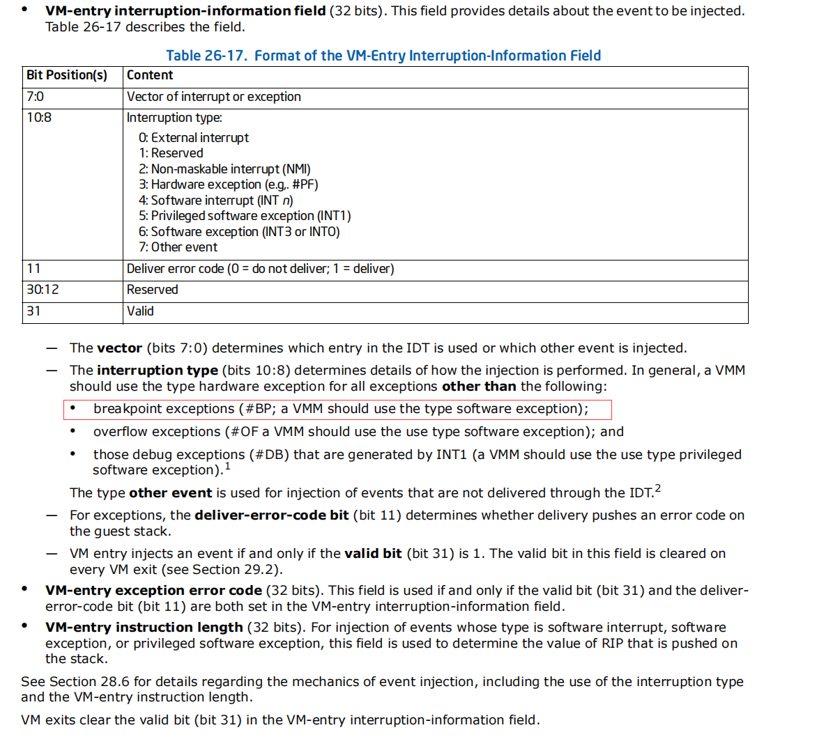

I'm developing my program using DBVM's KernelMode. During development, I'm using Windbg for dual-machine debugging. However, I noticed that when exceptions occur, Windbg consistently fails to locate the problematic context—the first-chance exception directly triggers a blue screen code.
Initially, I suspected a Windbg configuration issue. To test this, I wrote a simple ring-3 program that calls the BreakPoint function. Windbg still couldn’t break at the exception context, and after resuming execution, the entire virtual machine would freeze.
After rebooting ​​without DBVM​​, Windbg successfully captured the ring-3 program's exception. Resuming execution simply terminated the program due to unhandled exceptions, as expected. I then retested this on a Windows Hyper-V virtual machine and confirmed Windbg worked correctly.
Upon reviewing DBVM’s source code for handling VMEXIT_EXCP3 (breakpoint exceptions), I found this snippet:
sendstring("Realmode bp or No idtbypass\n");
currentcpuinfo->vmcb->EVENTINJ = 0;
currentcpuinfo->vmcb->inject_Type = 3; //exception
currentcpuinfo->vmcb->inject_Vector = int3redirection;
currentcpuinfo->vmcb->inject_Valid = 1;
currentcpuinfo->vmcb->inject_EV = 0;
return 0;
However, the ​​Intel Manual​​ specifies:
​​Interruption Type Encoding​​:
0: External interrupt
1: Reserved
2: Non-maskable interrupt (NMI)
3: Hardware exception (e.g., #PF)
​​6: Software exception (INT3 or INTO)​​
— The interruption type (bits 10:Cool determines details of how the injection is performed. In general, a VMM
should use the type hardware exception for all exceptions other than the following:
• breakpoint exceptions (#BP; a VMM should use the type software exception);
• overflow exceptions (#OF a VMM should use the use type software exception); and
• those debug exceptions (#DB) that are generated by INT1 (a VMM should use the use type privileged
software exception)
The type other event is used for injection of events that are not delive
Could this potentially be the root cause of the issue?​​
PS: After enabling DBVM, I can still set breakpoints normally when debugging my program in VS2022, which puzzles me
Intel manual

PostPosted: Tue May 20, 2025 6:02 pm    Post subject: Reply with quote
to be clear, are you using dbvm level debugging or kernelmode debugging ?
if kernelmode then the globaldebug tasksurfing is being used.which can be iffy at times (every debugregister access will pass by ce's driver then, not dbvm)
also, you're mixing intel vt documentation with AMD svm code
what cpu do you have ?

PostPosted: Tue May 20, 2025 7:02 pm    Post subject: Reply with quote
"I am not debugging. I am using VMCALL_KERNELMODE to transition directly from Ring 3 to Ring 0, but my code is encountering issues. I need to debug my custom code, which runs on an Intel i7 CPU.
ps:I'm using VMware Workstation 16 virtual machine.
I've reviewed Intel's exception handling code but didn't find any obvious issues, yet the problem persists. Additionally, I may have identified a minor potential flaw:
#define itHardwareException 3
if ((intinfo.interruptvector==1) && (intinfo.type==itHardwareException))
    if (handleHardwareBreakpoint(currentcpuinfo, vmregisters, fxsave))
      return VM_OK;
According to Intel's documentation, should the value of itHardwareException for hardware breakpoints be 5?

PostPosted: Sat May 24, 2025 1:49 am    Post subject: Reply with quote
3 is correct here. Interrupt1 is a hardware exception so that's ok. 5 is only for the int1 instruction
also which dbvm version are you using ?
