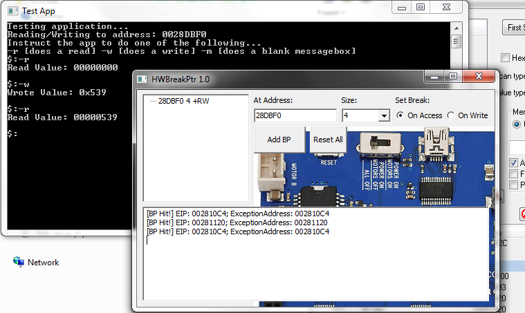

Hello! I am trying to implement a DLL that is able to set hardware breakpoints on access (type 3) / on write (type 1). I'm aware that type 2 (on read) isn't supported, at least, for windows it isn't, but not a big deal as type 3 can be used for that if you don't mind that writes will show up as well.
The funny thing is I have actually gotten it to work, and it works flawlessly in my test application. It's when I start using it on real world applications / actual games where the trouble comes in.
I think that my test application is a perfect little world where there isn't really anything going on, so it works fine. In a real application though there's alot more going on so I find the it tends to crash in many real applications / games where it doesn't ever in my test app.
One of first obstacles I made it passed, was the DBG_PRINTEXCEPTION_C problem described here: our forums -> viewtopic.php?t=519820
By skipping that exception in my vectored exception handler, debug prints don't cause an infinite loop.
What I don't get though is why does that exception even make it into an if statement like this:
if(ExceptionInfo->ExceptionRecord->ExceptionCode == EXCEPTION_SINGLE_STEP)
If the ExceptionCode IS EXCEPTION_SINGLE_STEP, then how can it also be DBG_PRINTEXCEPTION_C? In other words how can a debug print exception even make it into that if? For me it goes against all known logic.

My last problem I solved right before getting it working in my test application is resetting the Dr6 register to zero in the exception handler after a breakpoint is hit.
With that last change I was able to have it working without a crash in my test application.
I feel my problem might be in my exception handler code. Maybe I'm not passing certain exceptions down to other handlers when they need to be, causing crashes in certain games/apps that may have all kinds of exceptions happening and things going on.
So if the exception handler code is my problem, how can I make it bulletproof so that it will work in any executable without crashing it? In other words what code can I put in my exception handler so it only handles my set hardware breakpoints and passes everything else along smoothly?
See attached images for what it looks like and how it works...
As you can see it behaves how I would expect and how I want it to behave. The EIP displayed by the DLL in it's memo box for each time a breakpoint is hit, is the address of the instruction after the instruction which did the accessing/writing...
It works like this, upon the user setting a breakpoint through the GUI, it gathers all running threads, and locates a free debug register in the first thread it attempts to set the breakpoint on, by testing the bits in the Dr7 register. Then it set's the proper bits of the Dr7 register to enable that breakpoint for the first thread, and for the rest. The native OpenThread, NtOpenThread was used instead of the standard OpenThread as it wasn't working for me for some reason.
The project source along with binary containing the Hardware Breakpoint Setting DLL, "Project1.dll", and test app, "TestApp.exe" is downloadable here: httpizzle semi colon slash slash localhostr dot com/files/9254de/HWBreakPtr.zip
To test the dll just inject it in any game/application you wish to test it on, or just run the test app if testing it there. (It calls loadlibrary on it so no need to inject)
I'll post most of the code here however so you can see whats going on without a download.
I've contained most of the functionality within the "HWHooker" class.
Note: trying to use the class will result in undefined "HWHandler" as I defined that vectored exception handler in "Unit1.h" and just included it which is a bad way to do it, I'll probably change it so you pass the address of your exception handler to the class object instead.

ExceptionAddress given for write
 Filesize:  48.36 KB
 Viewed:  19180 Time(s)
In test application, flawless execution.
 Filesize:  123.58 KB

Thanks alot Dark Byte! I fixed my logic errors, and fixed the VCL GUI accessing from another thread issue. It seems to be running smoother now.
I was unaware that calling GUI code from multiple threads would cause crashing. It seemed to be working fine, but to avoid a crashing bug that I just can't seem to figure out why it's happening later on, I've changed it so I sendmessage/postmessage instead.

void __fastcall TForm1::FormCreate(TObject *Sender)
   MemoHandle = AccessedAddressesView->Handle;
and adjusted my DbgPrint function like so:
void DbgPrint(char *fmt, ...)
   va_list vl;
   char suffix[] = "\r\n";
   va_start(vl, fmt);
   wvsprintfA(msg, fmt, vl);
   va_end(vl);
   lstrcpyA(total, msg);
   lstrcatA(total, suffix);
   SendMessage(MemoHandle, EM_REPLACESEL, 0, (LPARAM)total); //good
   //Form1->AccessedAddressesView->Lines->Add(total); //bad
   OutputDebugStringA(total);
So that part should be all fine now.

My debug handler now looks like this:
LONG CALLBACK HWHandler(PEXCEPTION_POINTERS ExceptionInfo)
   hk->handlingexceptions = 1;
   if(ExceptionInfo->ExceptionRecord->ExceptionCode != DBG_PRINTEXCEPTION_C)
      //DbgPrint("Exception C0DE: %X", ExceptionInfo->ExceptionRecord->ExceptionCode);
         for(DWORD j = 0; j < hk->breakpoints->numitems; j++)
            Bp = (BREAKPOINT*)hk->breakpoints->GetObject(j);
            if(ExceptionInfo->ContextRecord->Dr6 & (1 << Bp->dbgreg)) //one of our breakpoints triggered the exception, so handle it!
               DbgPrint("EIP: %p; ExceptionAddress: %p", ExceptionInfo->ContextRecord->Eip, ExceptionInfo->ExceptionRecord->ExceptionAddress);
               ExceptionInfo->ContextRecord->Dr6 = 0xFFFF0FF0;
                   hk->handlingexceptions = 0;
               return EXCEPTION_CONTINUE_EXECUTION;
   return EXCEPTION_CONTINUE_SEARCH;
It seems like it's working alot better now, but I still have to fully test the new version it on all the games I tried it on previously to know for sure of its stability.
